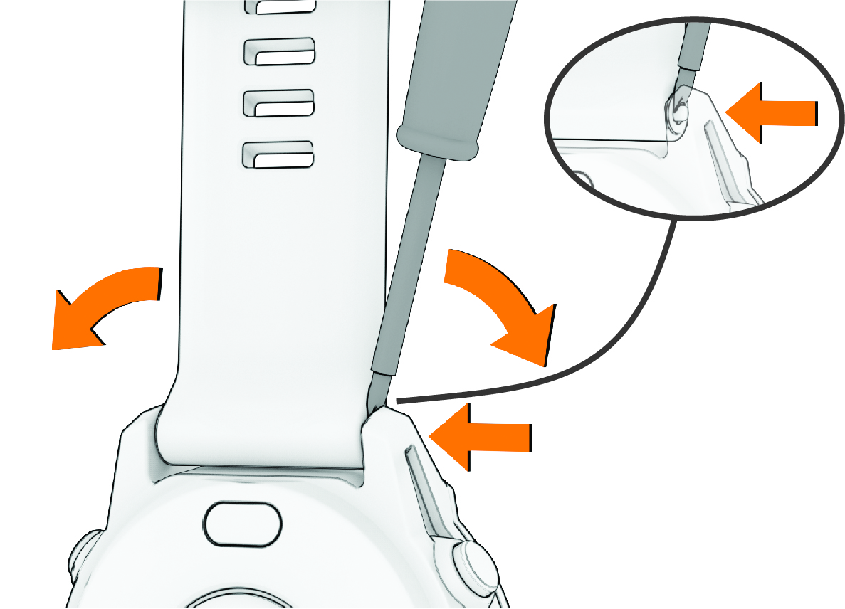

  1. Use the pin tool to push in the watch pin.
    Close-up view of the watch band attachment
  2. Remove the band from the watch.
  3. Select an option:
    • To install Forerunner bands, align one side of the new band with the holes on the device, push in the exposed watch pin, and press the band into place.
      NOTE: Make sure the band is secure. The watch pin should align with the holes on the device.
    • To install QuickFit 22 bands, remove the watch pin from the Forerunner band, replace the watch pin on the device, and press the new band into place.
      NOTE: Make sure the band is secure. The latch should close over the watch pin.
  4. Repeat the steps to change the other band.
