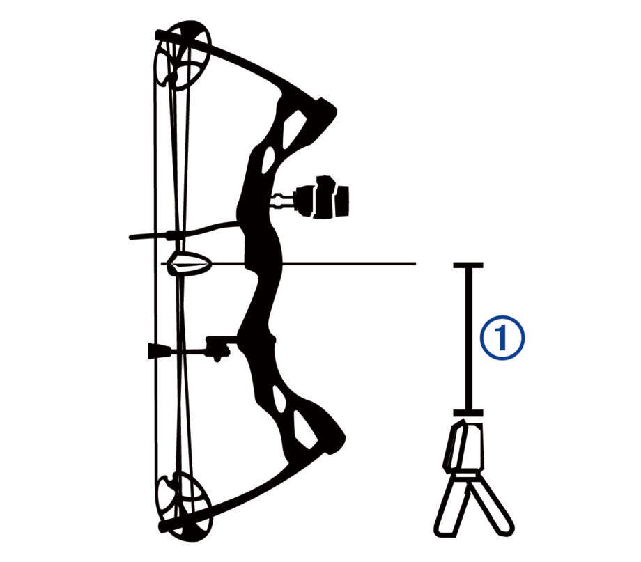

  4. Point the chronograph at the target with the screen facing you.
  5. Hold the bow over the chronograph so the arrow is 15 to 35 cm (5 to 15 in.) above the chronograph .
The device detects shots and displays measurements automatically as you shoot. The measured velocity is the speed of the arrow as it passes over the chronograph.
