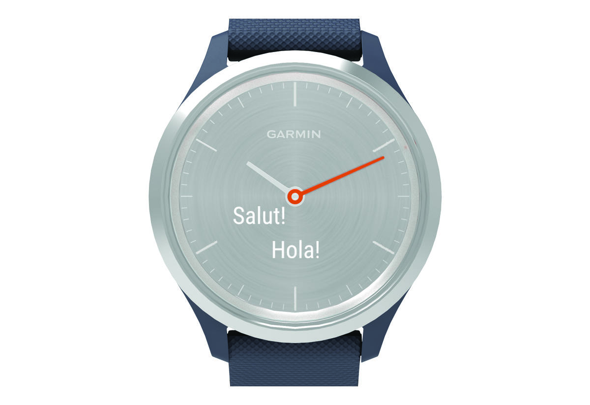

    Hello! appears when the device turns on
