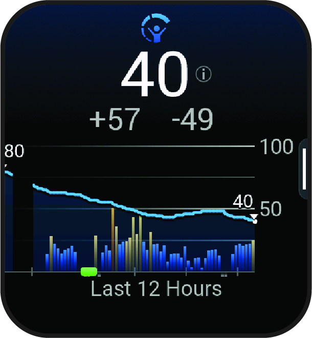

Viewing the Body Battery Glance
The Body Battery glance displays your current Body Battery level.
  1. Swipe up to view the Body Battery glance.
NOTE: You may need to add the glance to your glance loop (Customizing the Glance List).
  1. Select the glance to view a graph of your latest Body Battery data.
You can tap for more information. You can select for menu options.
  1. Swipe up to view a combined graph of your Body Battery and stress level.
  2. Swipe up to view a list of factors impacting your Body Battery level.
NOTE: Select each factor to view more details.
