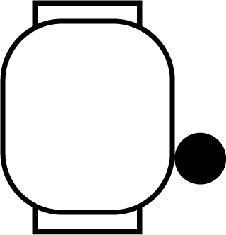

  1. From the watch face, press .
  2. Select an option:
  3. If the activity requires GPS signals, go outside to an area with a clear view of the sky, and wait until the watch is ready.
The watch is ready after it establishes your heart rate, acquires GPS signals (if required), and connects to your wireless sensors (if required).
  1. Press to start the activity timer.

  1. Press .
