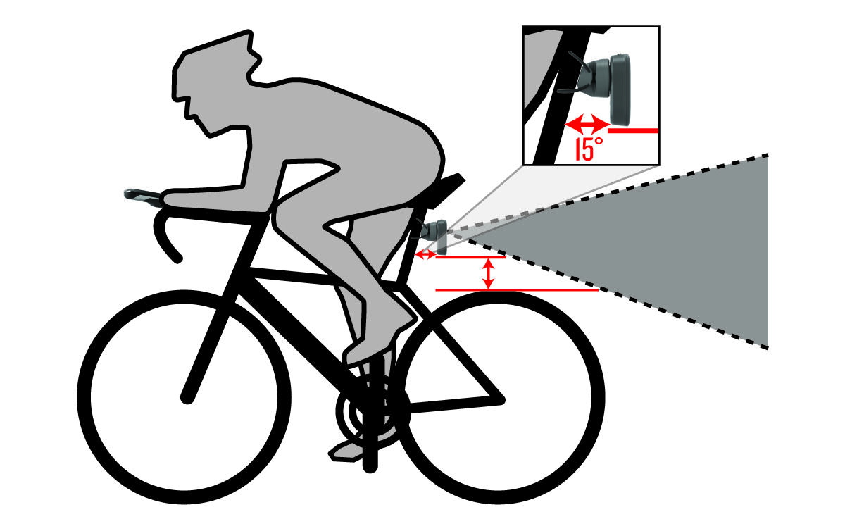

  • Select a secure location to mount the device where it does not interfere with the safe operation of your bike.
  • Mount the device as high on the seat post as possible for optimal radar detection.
    NOTE: The mount surface should be vertical. The mounts are designed to accommodate most seat post angles.
  • Mount the Varia RVR315 device on the seat post 250 mm to 1200 mm above the road.
  • Install the device correctly.
    The device faces backward and is perpendicular to the road.
