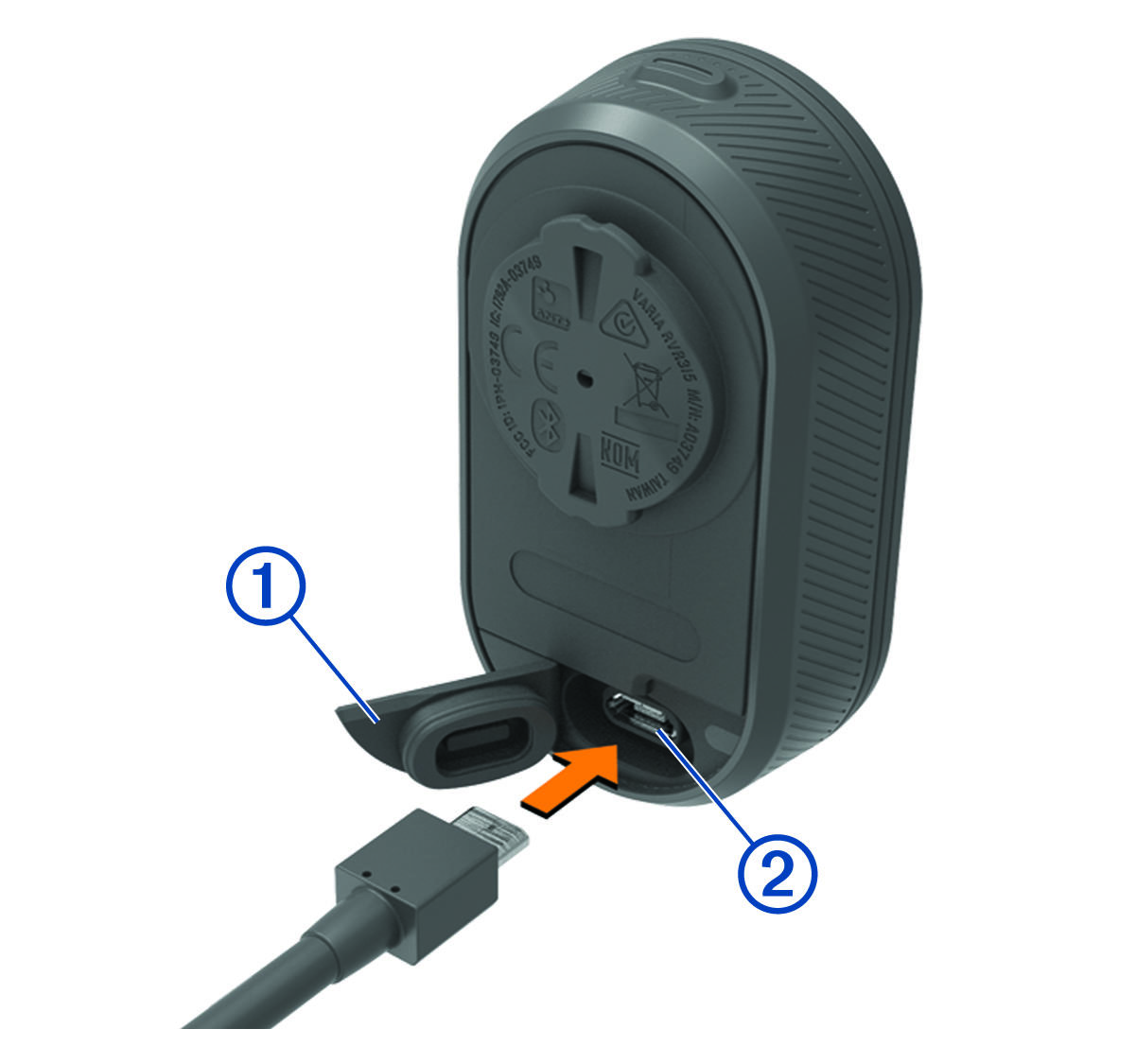

  1. Pull up the weather cap from the USB port .
  2. Plug the small end of the USB cable into the USB port on the device.
  3. Plug the large end of the USB cable into an AC adapter or a computer USB port.
