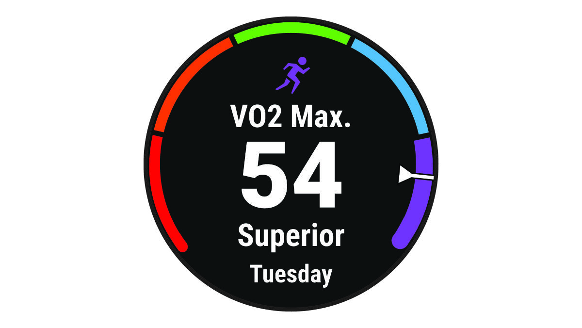

About VO2 Max. Estimates
VO2 max. is the maximum volume of oxygen (in milliliters) you can consume per minute per kilogram of body weight at your maximum performance. In simple terms, VO2 max. is an indication of athletic performance and should increase as your level of fitness improves. The fēnix device requires wrist-based heart rate or a compatible chest heart rate monitor to display your VO2 max. estimate. The device has separate VO2 max. estimates for running and cycling. You must run either outside with GPS or ride with a compatible power meter at a moderate level of intensity for several minutes to get an accurate VO2 max. estimate.
On the device, your VO2 max. estimate appears as a number, description, and position on the color gauge. On your Garmin Connect account, you can view additional details about your VO2 max. estimate, such as where it ranks for your age and gender.

Getting Your VO2 Max. Estimate for Running
This feature requires wrist-based heart rate or a compatible chest heart rate monitor. If you are using a chest heart rate monitor, you must put it on and pair it with your device (Pairing Your Wireless Sensors).
For the most accurate estimate, complete the user profile setup (Setting Up Your User Profile), and set your maximum heart rate (Setting Your Heart Rate Zones). The estimate may seem inaccurate at first. The device requires a few runs to learn about your running performance. You can disable VO2 max. recording for ultra run and trail run activities if you do not want those run types to affect your VO2 max. estimate (Activities and App Settings).
  1. Run for at least 10 minutes outdoors.
  2. After your run, select Save.
  3. Select UP or DOWN to scroll through the performance measurements.
    TIP: You can select START to view additional information.

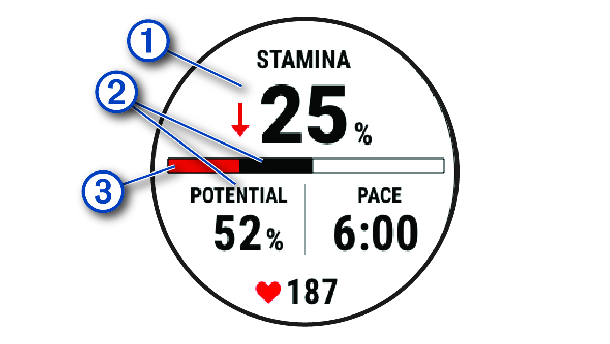

Viewing Your Real-Time Stamina
Your watch can provide real-time stamina estimates based on your heart rate data and VO2 max. estimate (About VO2 Max. Estimates).
  1. Hold MENU.
  2. Select Activities & Apps.
  3. Select a run or bike activity.
  4. Select the activity settings.
  5. Select Data Screens > Add New > Stamina.
  6. Press UP or DOWN to change the location of the data screen (optional).
  7. Press START to edit the primary stamina data field (optional).
  8. Start your activity (Starting an Activity).
  9. Press UP or DOWN to scroll to the data screen.
Primary stamina data field. Shows your current stamina percentage, distance remaining, or time remaining.
Potential stamina.
Actual stamina.
Red: Stamina is depleting.
Orange: Stamina is steady.
Green: Stamina is recharging.
