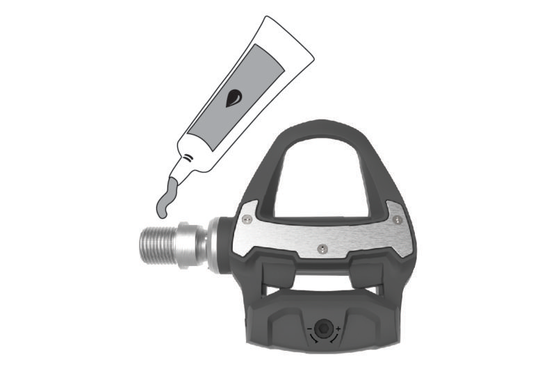

- Apply a thin layer of bike grease to the spindle.

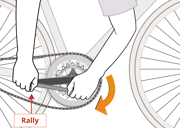

- Tighten the spindle with a torque wrench or a pedal wrench.
NOTE: Tighten the spindle to the recommended 25 ft-lb (34 N-m) by using a torque wrench if available, or as tight as possible using a pedal wrench.

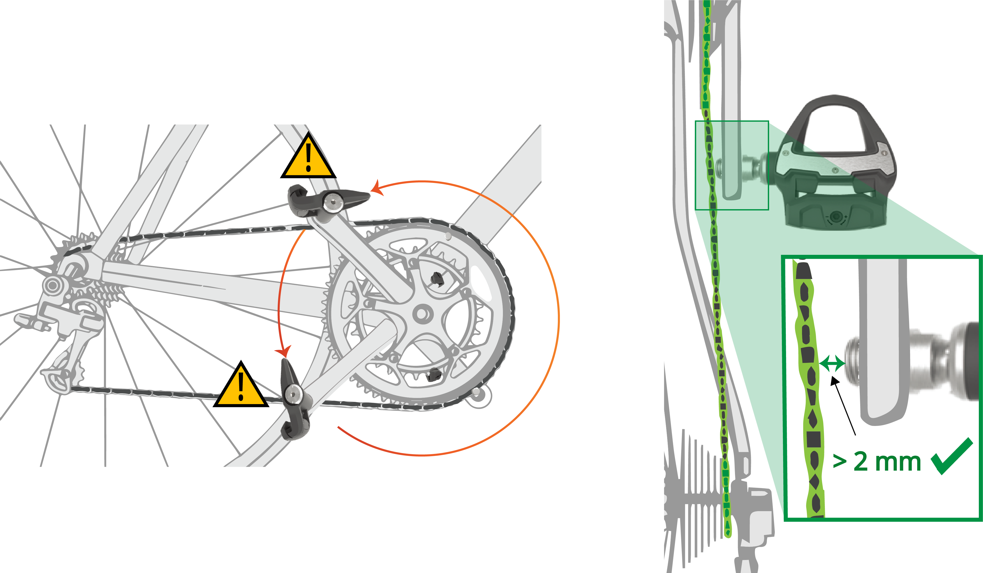

- Rotate the crank arm to check for chain clearance.

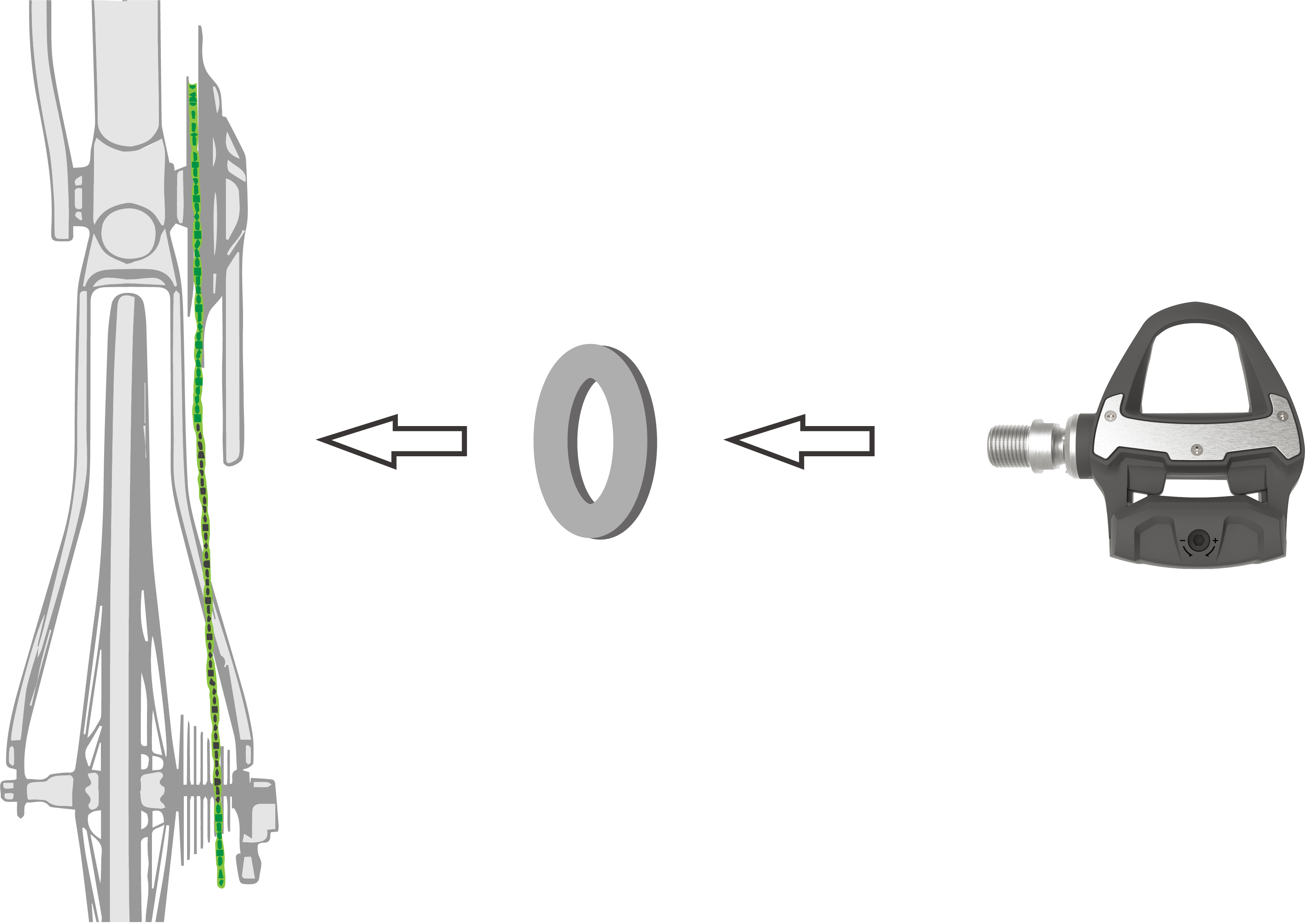

If your pedal rubs the bike chain, you can add one pedal washer between the spindle and the crank arm to increase clearance. To maintain an equal q factor, you can add one washer to the left pedal spindle.
WARNING
Do not add more than one washer to each pedal. Doing so could increase the stress on the pedal spindle and spindle threads causing possible damage to the pedals or bike or a possible crash leading to property damage or serious personal injury.

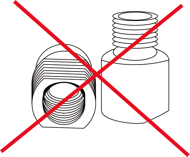

Do not install with bike pedal extenders as doing so may damage the device and will void the warranty.
