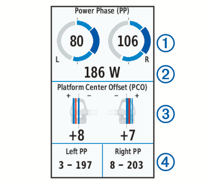

- Scroll to the cycling dynamics screen to view your power phase data
, total power
, and platform center offset
- If necessary, hold a data field
to change it (Customizing the Data Fields).NOTE: The two data fields at the bottom of the screen can be customized.
