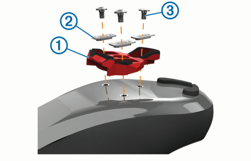

Installing the Shoe Cleats for Rally RS and Rally RK
NOTE: The left and right cleats are the same.
- Apply a thin layer of grease on the cleat bolt threads.
- Align the cleat
, washers
, and bolts
- Use a 4 mm hex key to loosely attach each bolt to the sole of the shoe.
- Adjust the cleat to the shoe in your preferred position. This can be adjusted after a trial ride.
- Tighten the cleat firmly to the shoe.
NOTE: Garmin recommends a torque of 4 to 6 lbf-ft. (5 to 8 N-m).
