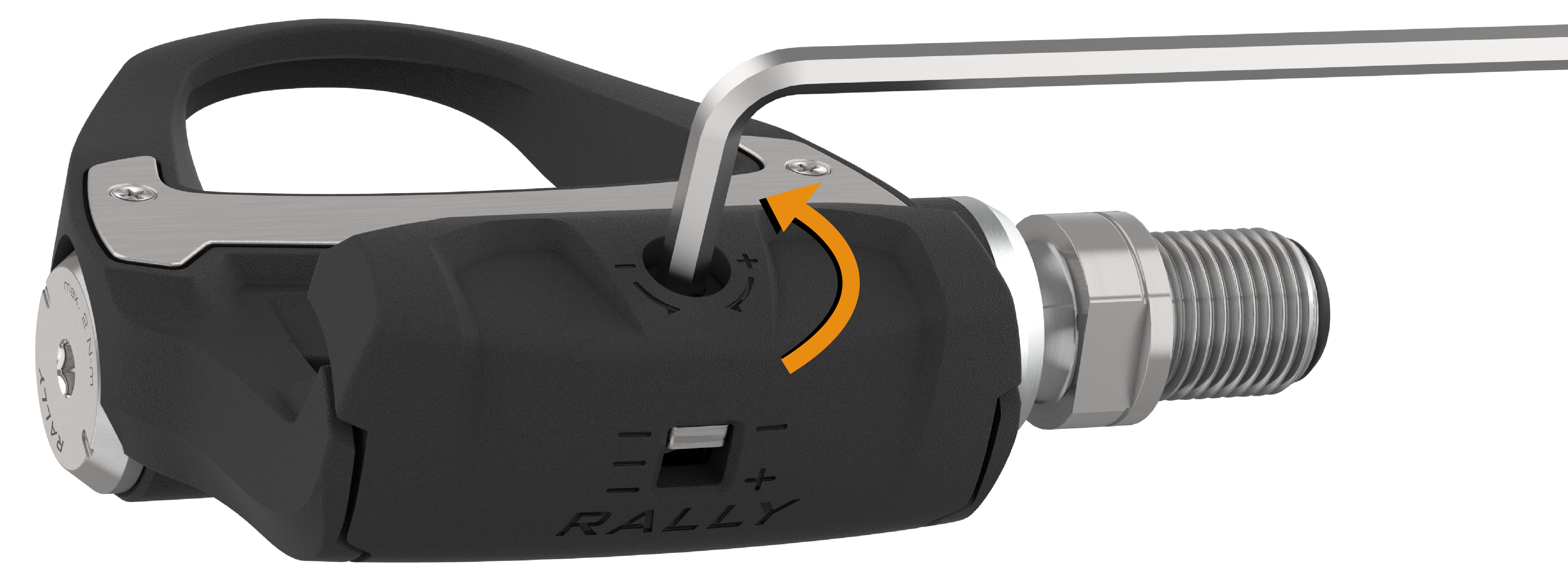

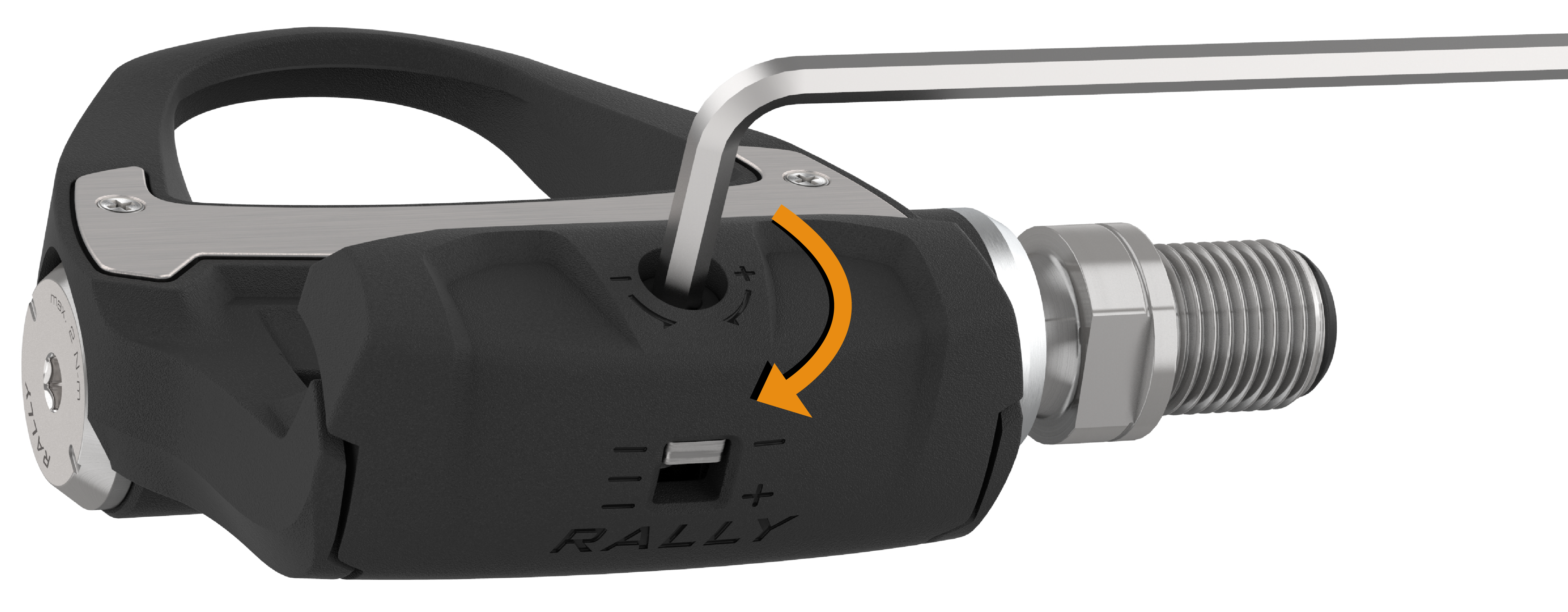

You can use a 3 mm hex key to adjust the release tension of each pedal.
  • For a tighter feel, rotate the hex key clockwise to increase the release tension.
  • For a lighter feel, rotate the hex key anti-clockwise to decrease the release tension.

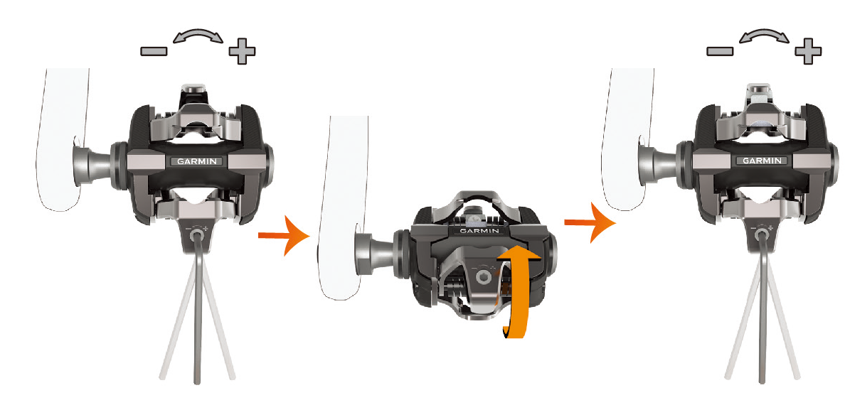

Rally XC
You can use a 3mm hex key to adjust the pedal tension on both sides of both pedals.
