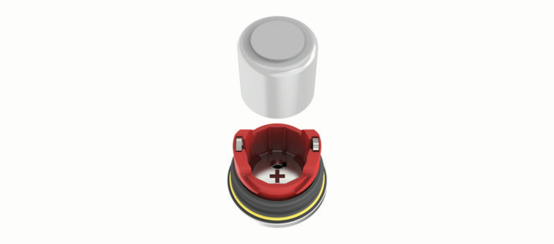

Each Rally 200 pedal uses one CR1/3N battery.
NOTE: Garmin recommends replacing all of the batteries at the same time. Do not mix the battery types.
- Use a 4 mm hex key to remove the battery cover
- Remove the battery.
- Wait 5 to 10 seconds.
- Insert the new battery into the battery cover, observing polarity.
- Replace the battery cover, and hand tighten it.
NOTE: Do not damage or lose the O-ring gasket.
- Use a 4 mm hex key to tighten the battery cover to 3.6 lbf-ft. (5 N-m).
The LED displays one short green flash followed by one long red flash.
