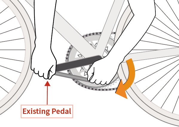

- Attach the pedal wrench to the spindle with the pedal wrench pointing towards the rear of the bike.
- While holding the pedal in place with one hand, push down on the pedal wrench with the other hand.
Non-Drive Side

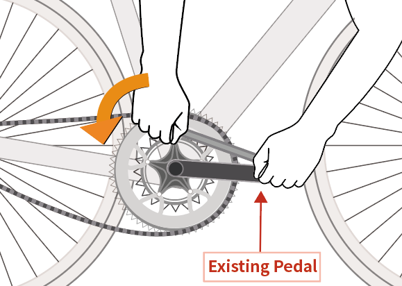

Drive Side
- Continue rotating the pedal wrench in the same direction until the pedal comes off.
