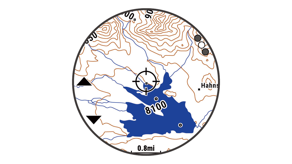

Saving or Navigating to a Location on the Map
You can select any location on the map. You can save the location or start navigating to it.
  1. From the map, hold MENU.
  2. Select Pan/Zoom.
    Controls and crosshairs appear on the map.
  3. Pan and zoom the map to center the location in the crosshairs.
  4. Hold MOB to select the point indicated by the crosshairs.
  5. If necessary, select a nearby point of interest.
  6. Select an option:
    • To start navigating to the location, select Go.
    • To save the location, select Save Location.
    • To view information about the location, select Review.
