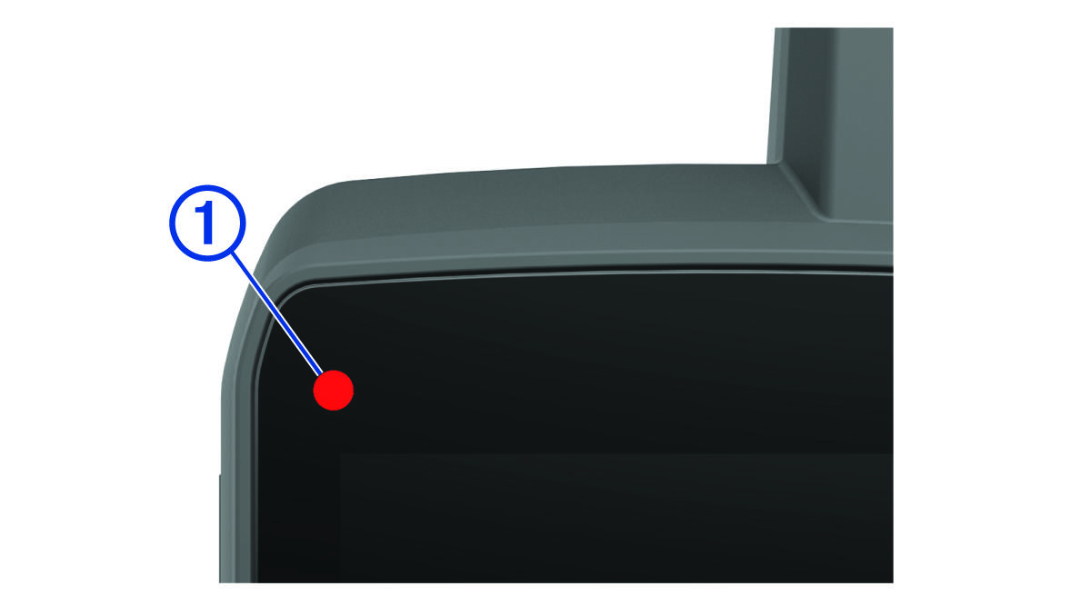

Status LED
The status LED
indicates the device status.
LED Activity |
Status |
Double flashing green |
You have an unread inReach message. |
Flashing green |
The device is in expedition mode. |
Flashing red |
An inReach message failed to send. The device is below 10-percent battery power. |
Alternating red and green flashes |
The device is in SOS mode. |
