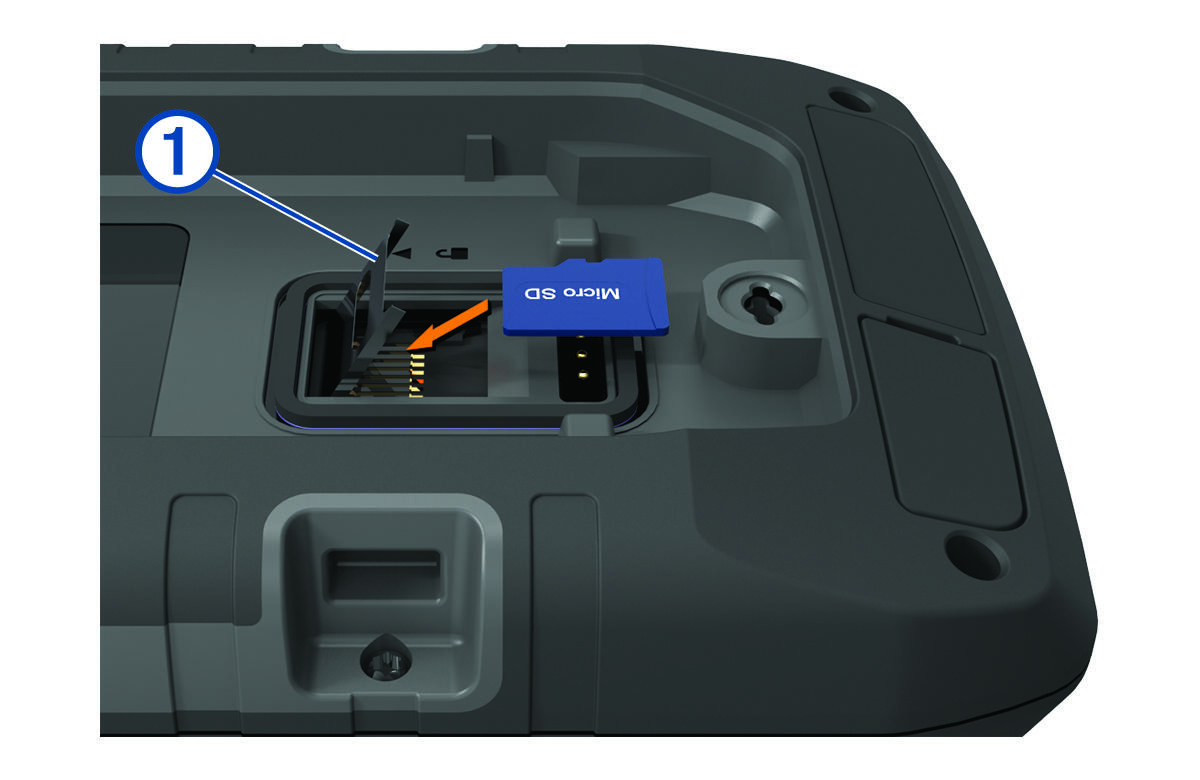

You can install a microSD memory card, up to 32 GB, in the handheld device for additional storage or pre-loaded maps.
  1. Turn the D-ring counter-clockwise, and pull up to remove the battery pack.
  2. Slide the card holder to and lift up.
  3. Place the memory card with the gold contacts facing down.
  4. Close the card holder.
  5. Slide the card holder to to lock it.
  6. Replace the battery pack.
