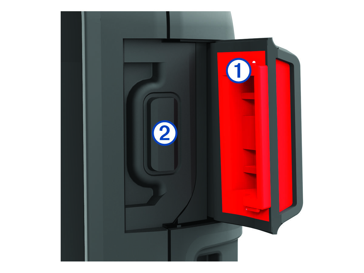

  1. Lift the protective cap from the SOS button .
  2. Press and hold the SOS button.
