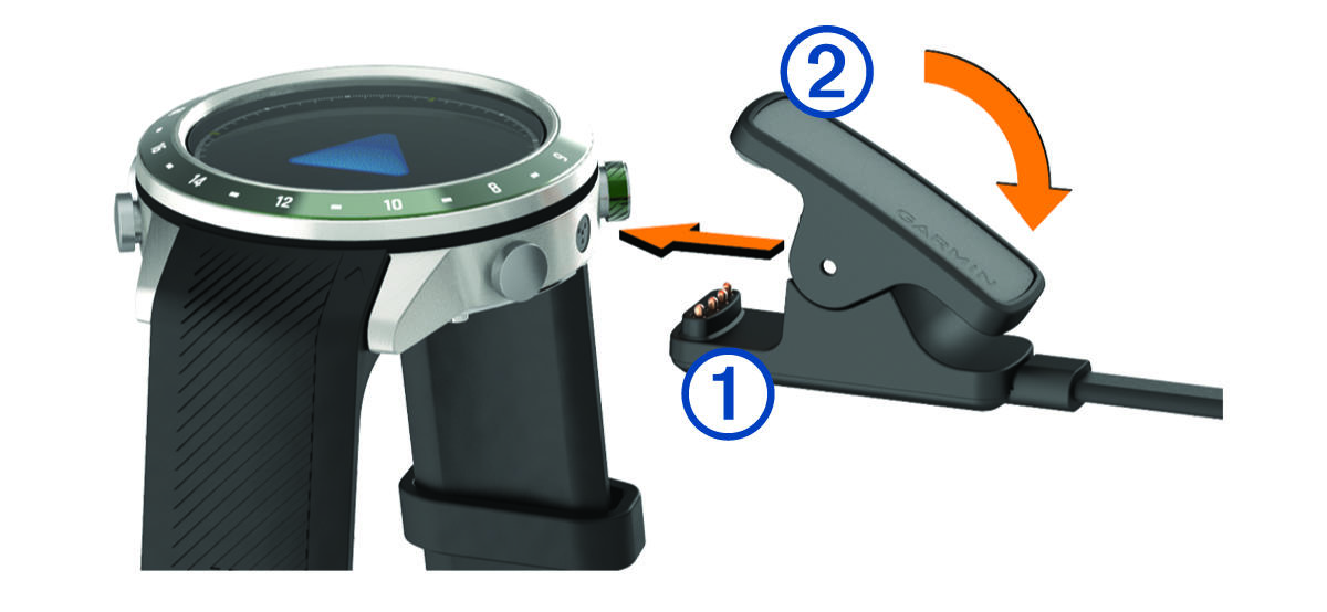

  1. Align the charger posts with the contacts on the back of the device, and connect the charging clip securely to the device.
  2. Plug the USB cable into a USB charging port.
  3. Charge the device completely.
  4. Press to remove the charger.
