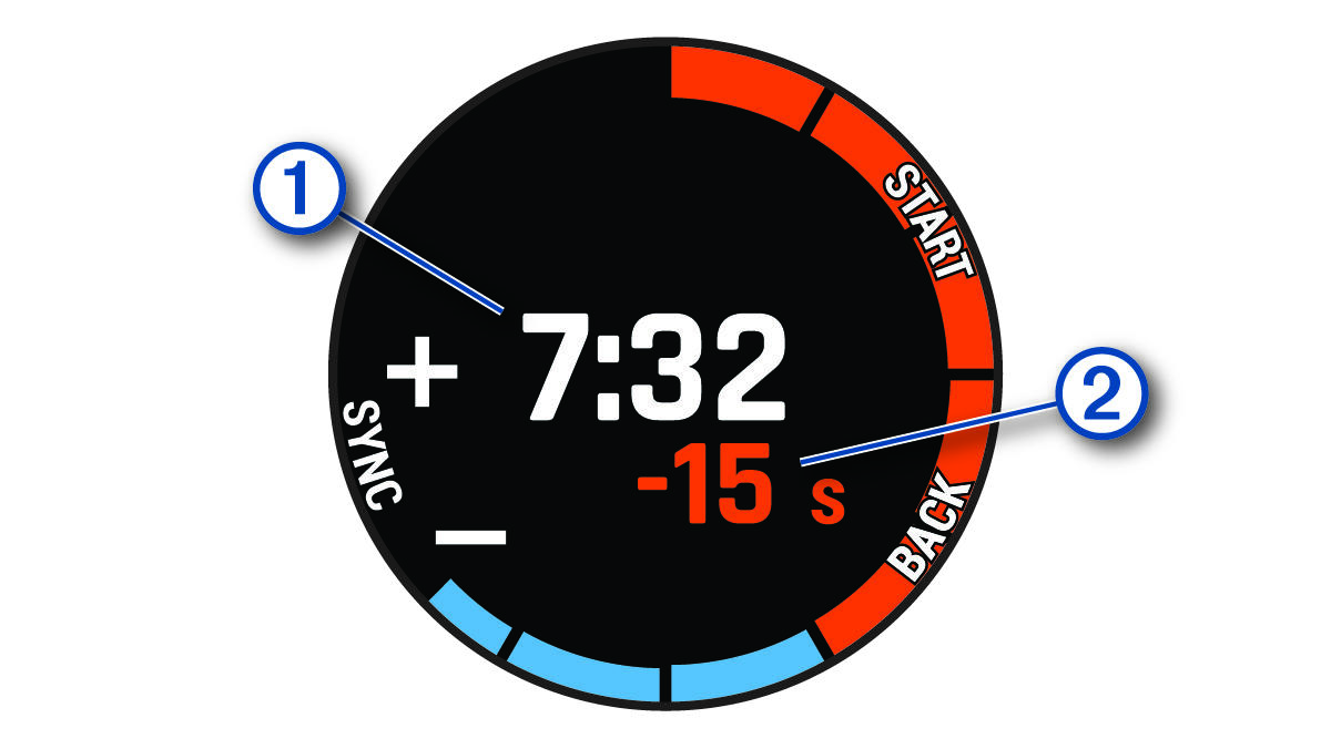

Starting a Race
Before you can view the time to burn, you must set the starting line (Setting the Starting Line).
  1. From the watch face, select START > Sail Race.
  2. Wait while the device locates satellites.
    The screen displays the regatta timer and time to burn .
  3. Select START.
  4. Select UP and DOWN to synchronize the regatta timer with the official race countdown.
    NOTE: When the burn time is negative, you will arrive at the start line after the race starts. When the burn time is positive, you will arrive at the start line before the race starts.
  5. Select START to start the timer.
