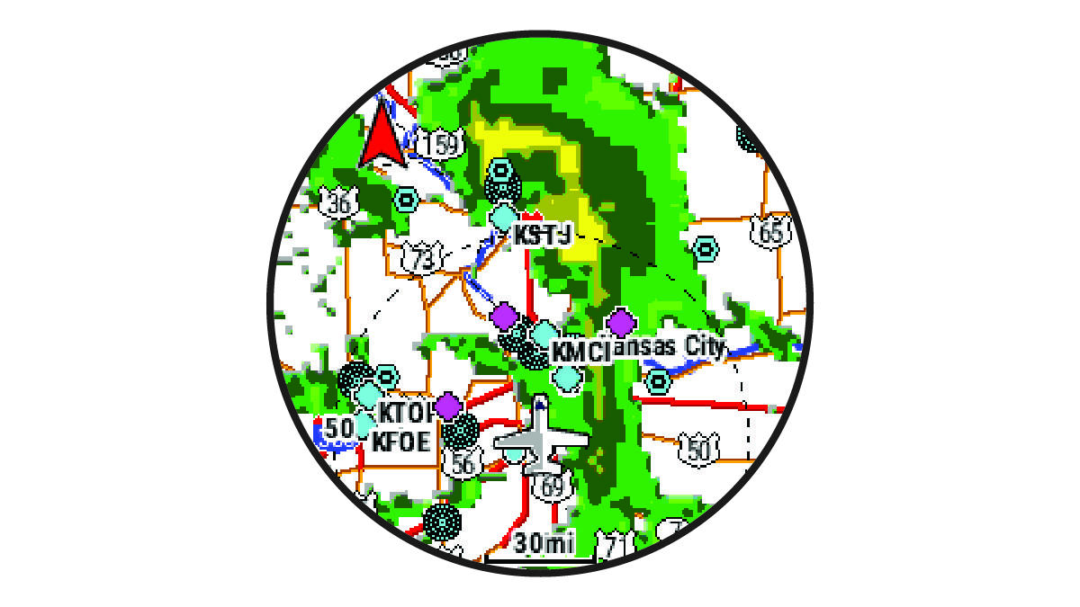

You can view the weather radar image associated with your current location.
NOTE: You can customize the NEXRAD Tiles option in the Aviation settings to download additional weather radar images based on a direction from your current location ().
  1. At any time, hold DOWN and START at the same time.
The device downloads a square of radar data for your current GPS position, outlined in magenta. The radar data is active for 5 minutes.
NOTE: If you are near the border of the square, you may not see all applicable radar data.
  1. If necessary, hold DOWN and START to download new data.
