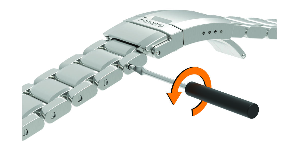

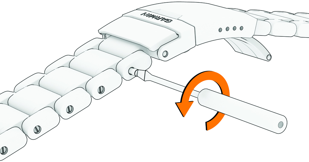

  • Use a small screwdriver to unscrew the links.
  • Remove an equal number of links from both sides of the clasp.
    This helps your watch stay centered on your wrist.

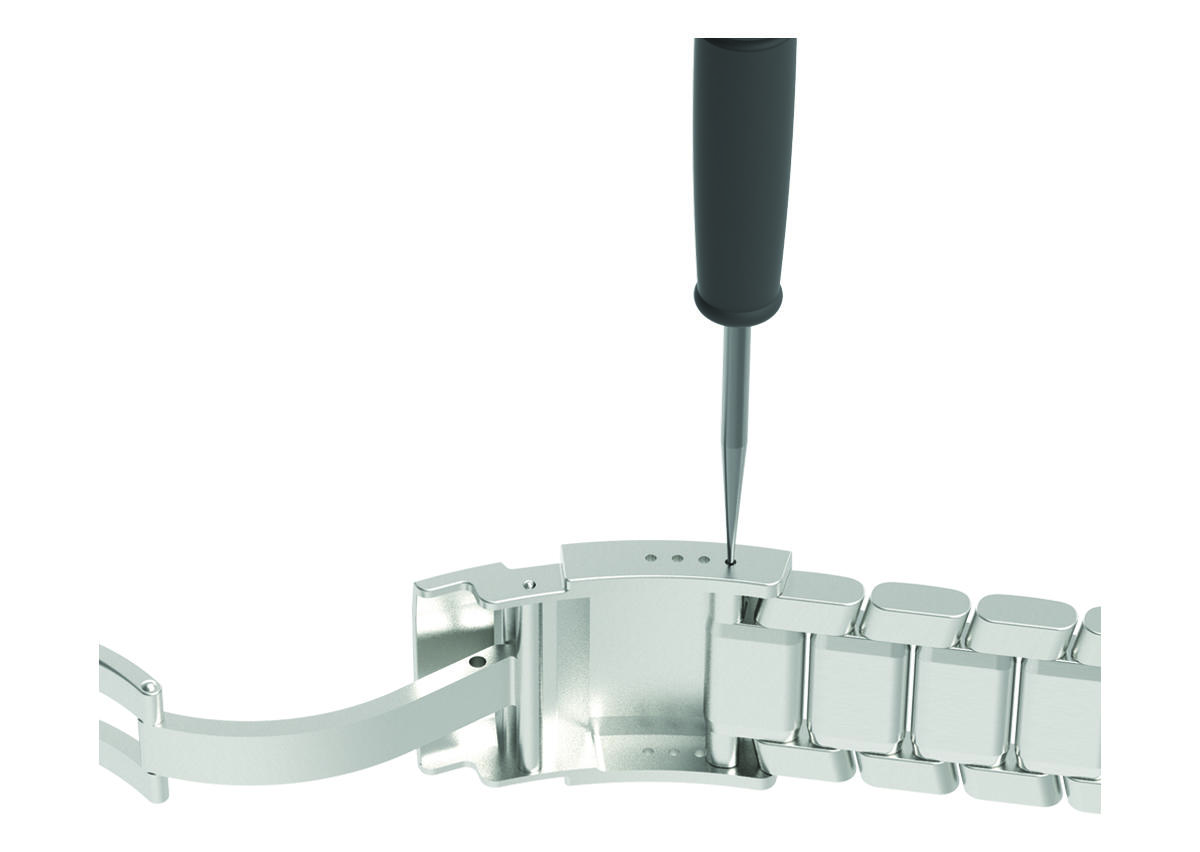

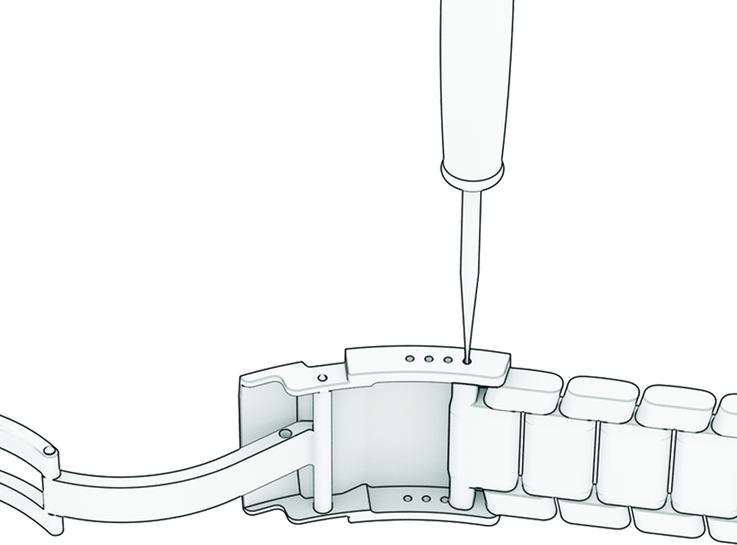

  • Use a pin removal tool to reposition the spring bar in the clasp for finer size adjustment.
    Use caution when making size adjustments to the clasp. The pin is compressed, and can move unexpectedly when released.
