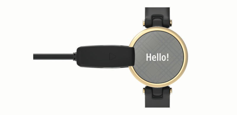

  2. Pinch the charging clip .
  3. Align the clip with the contacts on the back of the device .
  4. Plug the USB cable into a power source to turn on the device (Charging the Device).
    Hello! appears when the device turns on.
