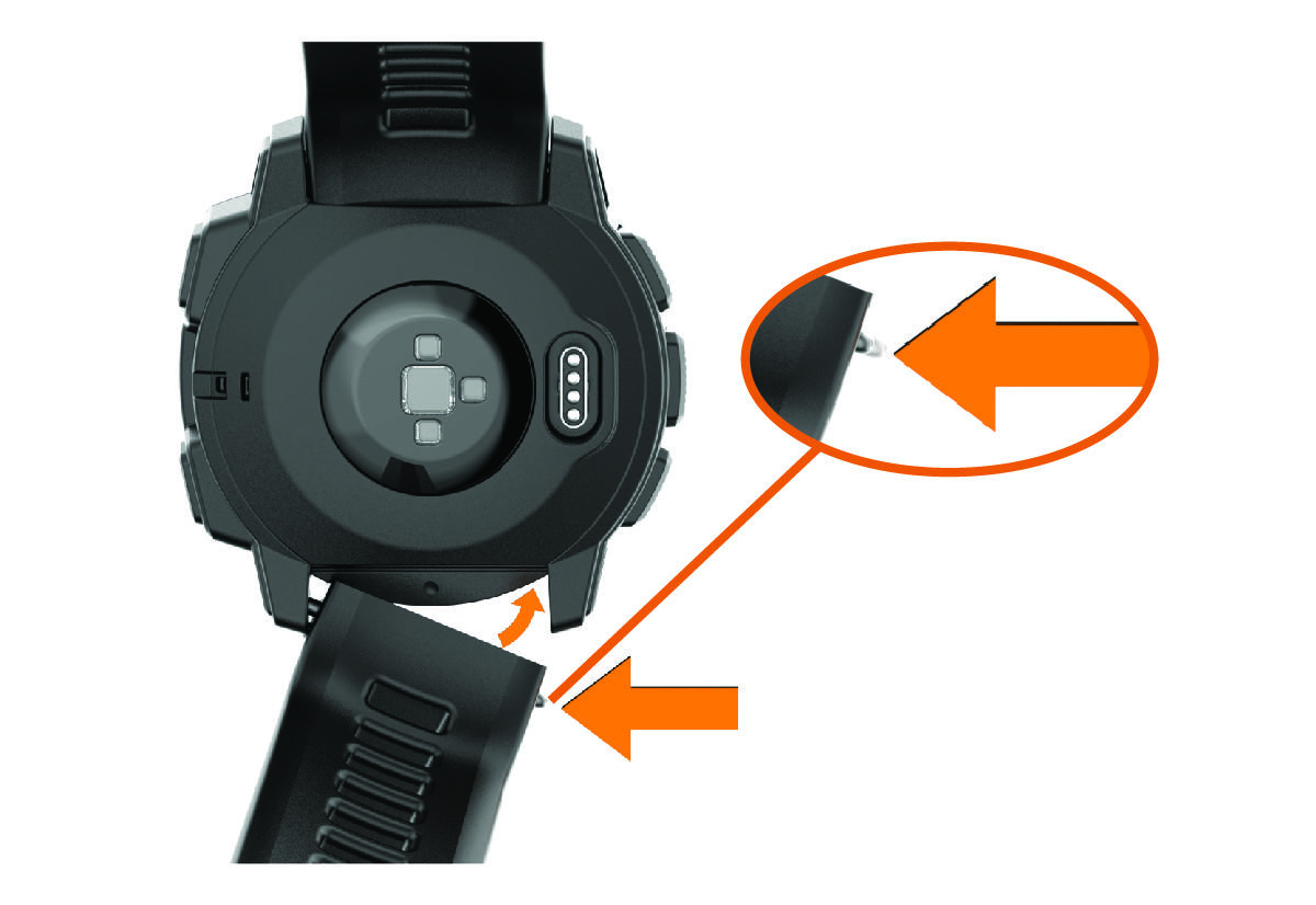

You can replace the bands with new Instinct bands or compatible QuickFit 22 bands.
  1. Use a paper clip to push in the watch pin.
  2. Remove the band from the watch.
  3. Select an option:
    • To install Instinct bands, align one side of the new band with the holes on the device, push in the exposed watch pin, and press the band into place.
NOTE: Make sure the band is secure. The watch pin should align with the holes on the device.

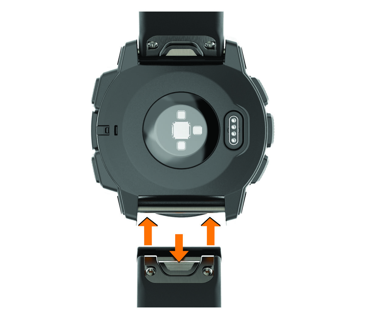

  • To install QuickFit 22 bands, remove the watch pin from the Instinct band, replace the watch pin on the device, and press the new band into place.
NOTE: Make sure the band is secure. The latch should close over the watch pin.
  1. Repeat the steps to change the other band.
