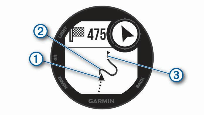

Navigating to Your Starting Point During an Activity
You can navigate back to the starting point of your current activity in a straight line or along the path you traveled. This feature is available only for activities that use GPS.
  1. During an activity, press GPS > Back to Start.
  2. Select an option:
    • To navigate back to the starting point of your activity along the path you traveled, select TracBack.
    • To navigate back to the starting point of your activity in a straight line, select Straight Line.
Your current location , the track to follow , and your destination appear on the map.
