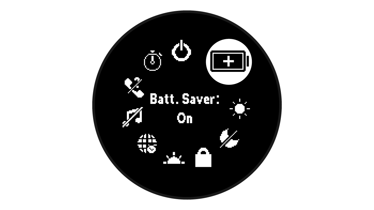

  • Hold CTRL to view the controls menu.
The controls menu provides quick access to frequently used functions, such as turning on do not disturb mode, turning on the battery saver feature, and turning the watch off.

Viewing the Controls Menu
The controls menu contains options, such as turning on do not disturb mode, locking the keys, and turning the device off.
NOTE: You can add, reorder, and remove the options in the controls menu (Customizing the Controls Menu).
  1. From any screen, hold CTRL.
  1. Press UP or DOWN to scroll through the options.
