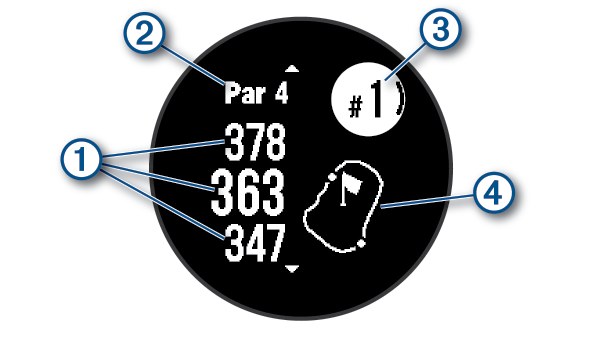

The hole information screen appears.
Distance to the front, middle, and back of the green
Par for the hole
Current hole number
Map of the green
NOTE: Because pin locations change, the watch calculates the distance to the front, middle, and back of the green, but not the actual pin location.
