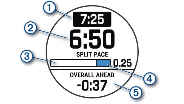

Before you can start a PacePro plan, you must download a plan from your Garmin Connect account.
- From the watch face, press GPS.
- Select an outdoor running activity.
- Hold MENU.
- Select Training > PacePro Plans.
- Select a plan.
- Press GPS.
TIP: You can preview the splits, elevation plot, and the map before you accept the PacePro plan.
- Select Accept Plan to start the plan.
- If necessary, select
to enable course navigation. - Press GPS to start the activity timer.
Target split pace |
Current split pace |
Completion progress for the split |
Distance remaining in the split |
Overall time ahead of or behind your target time |
TIP: You can hold MENU, and select Stop PacePro >
to stop the PacePro plan. The activity timer continues running.
