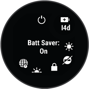

Controls
The controls menu lets you quickly access watch features and options. You can add, reorder, and remove the options in the controls menu ().
From any screen, hold CTRL.
