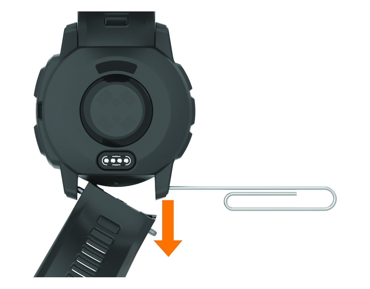

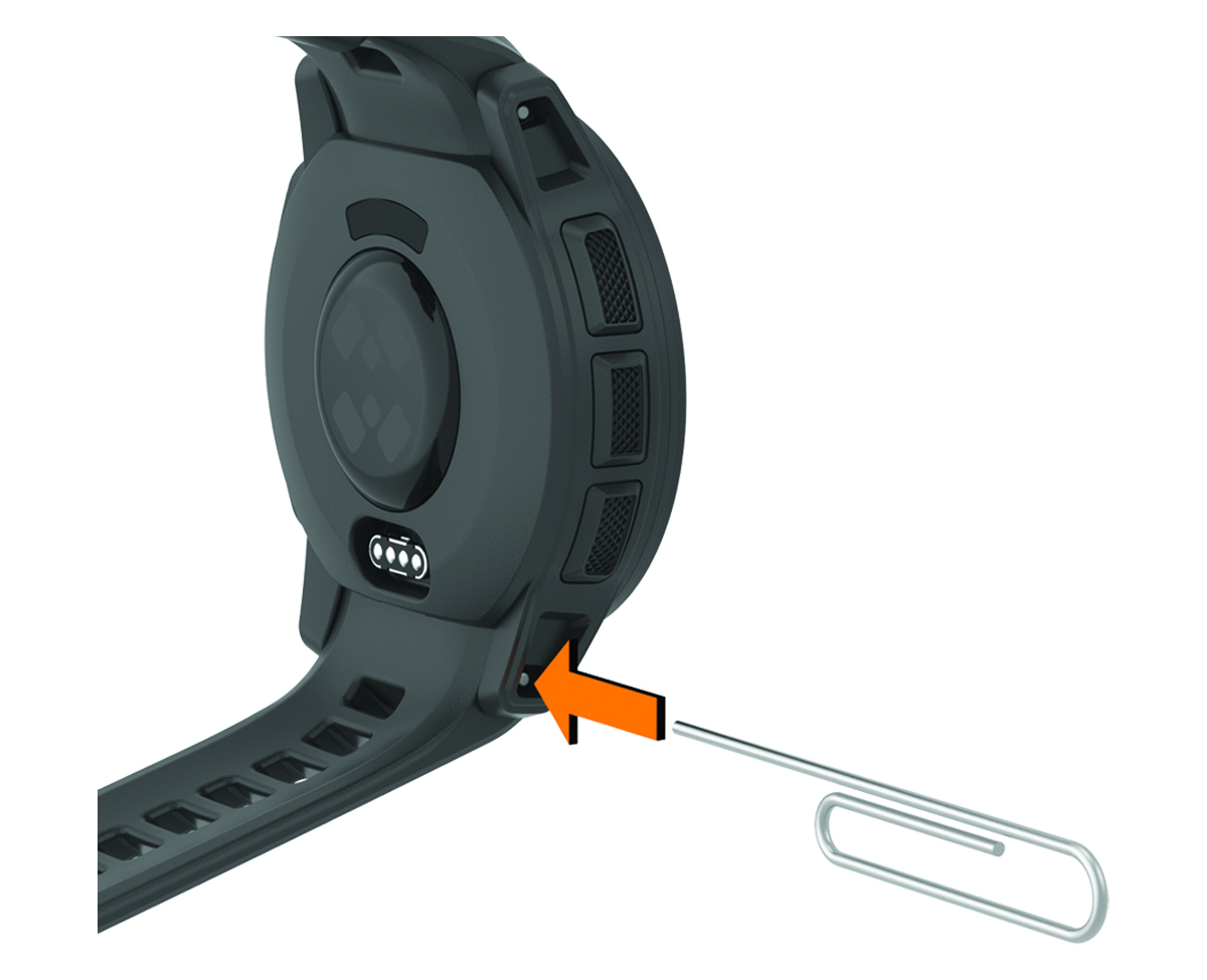

  1. Use the pin tool to push in the watch pin.
  1. Remove the band from the watch.

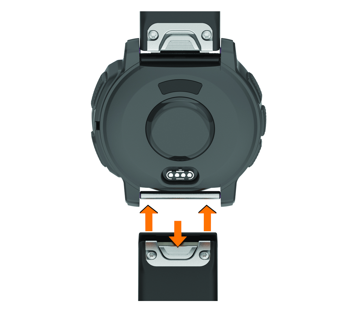

  1. Select an option:

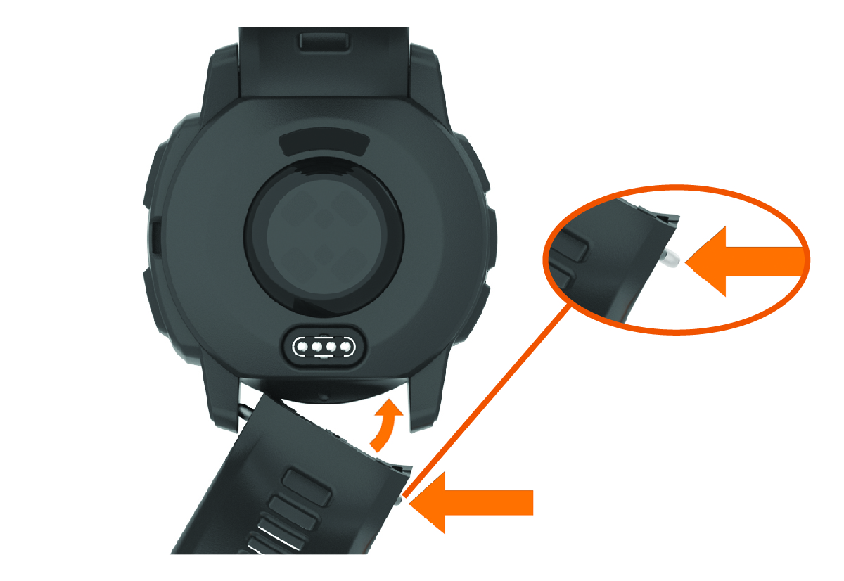

    • To install Instinct 2 Solar ONE PIECE bands, align one side of the new band with the holes on the device, push in the exposed watch pin, and press the band into place.
NOTE: Make sure the band is secure. The watch pin should align with the holes on the device.
  • To install QuickFit 22 bands, remove the watch pin from the Instinct 2 Solar ONE PIECE band, replace the watch pin on the device, and press the new band into place.
NOTE: Make sure the band is secure. The latch should close over the watch pin.
