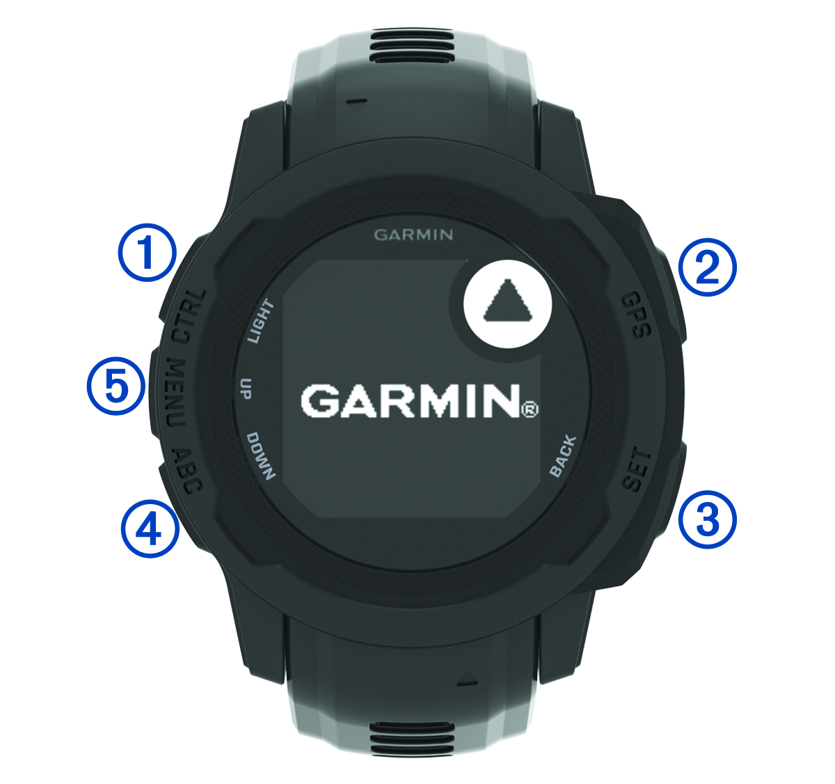

Buttons
LIGHT CTRL |
Press to turn the backlight on and off. Press to turn the device on. Hold to view the controls menu. |
GPS |
Press to view the activity list and start OR stop an activity. Press to choose an option in a menu. Hold to view GPS coORdinates and save your location. |
BACK SET |
Press to return to the previous screen. Hold to view the clock menu. |
DOWN ABC |
Press to scroll through the glance loop and menus. Hold to view the altimeter, barometer, and compass (ABC) screen. |
UP MENU |
Press to scroll through the glance loop and menus. Hold to view the menu. |
