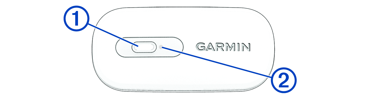

  1. On the HRM 600 module, press the button to wake it up.
The LED flashes when it is active and transmitting.
