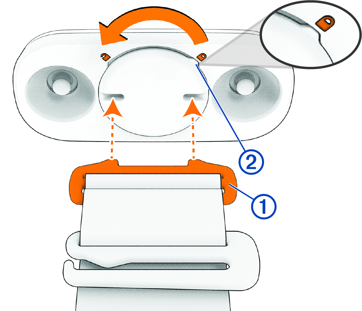

The HRM 200 strap has a tool for opening the battery cover.
  1. Unsnap and remove the module.
  2. Locate the size-adjustment slider on the HRM 200 strap.
The slider is also the battery cover tool.
  1. Insert the tool into the notches on the cover, press firmly, and turn the cover counterclockwise.
The tab points to unlocked .

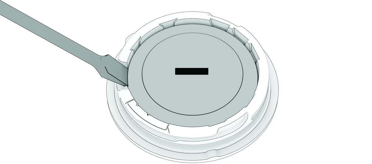

  1. Remove the cover and the battery.
  2. Gently lift the battery out of the cover at the pry point.

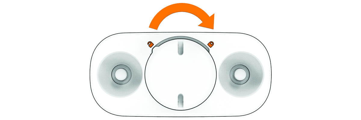

  1. Insert the tool into the notches on the cover, and turn the cover clockwise.
The tab points to locked .
