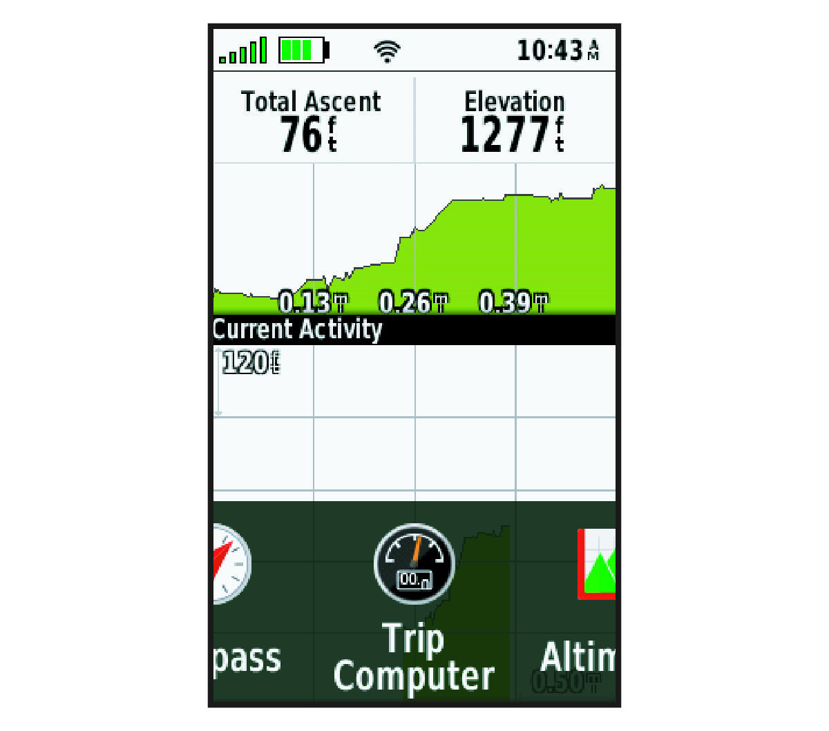

Configuring the Page Ribbon Display
  1. Select Setup > Menus > Page Sequence > Page Ribbon Display.
  2. Select an option:
    • To disable the page ribbon display, select Off.
    • To set the speed at which a page opens after being selected in the page ribbon display, select Slow or Fast.
