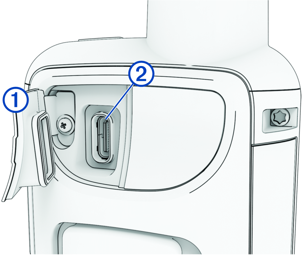

Charging the GPSMAP 67 Device
NOTICE
To prevent corrosion, thoroughly dry the USB port, the weather cap, and the surrounding area before charging or connecting to a computer.
NOTE: The device does not charge when it is outside the approved temperature range (Specifications).
  1. Lift the weather cap .
  1. Plug the small end of the power cable into the charging port on the device.
  2. Plug the other end of the power cable into a compatible AC power adapter.
  3. Plug the AC power adapter into a standard wall outlet.
The device displays the current battery charge level.
