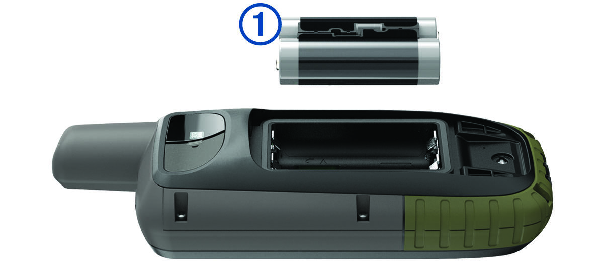

Installing a NiMH Battery Pack
The device operates using a NiMH battery pack (optional) or two AA batteries (Installing Batteries).
  1. Turn the D-ring counter-clockwise, and pull up to remove the cover.
  2. Locate the battery pack .
  3. Insert the battery pack, observing polarity.
  4. Gently press the battery pack into place.
  5. Replace the battery cover, and turn the D-ring clockwise.
