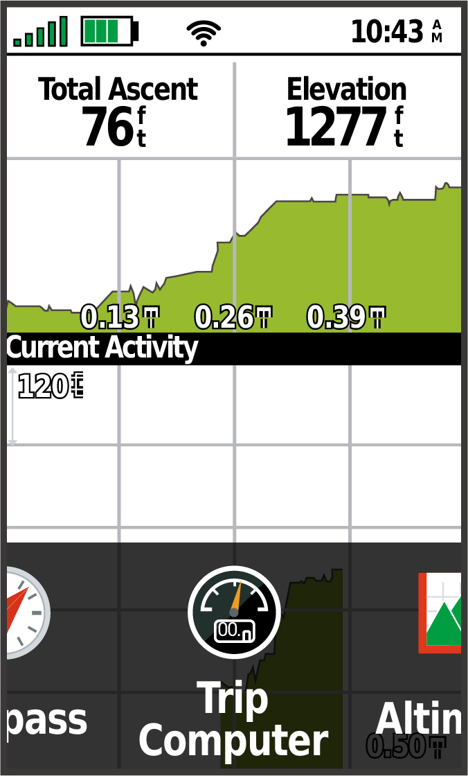

Menu Settings
Select Setup > Menus.
Menu Style: Changes the appearance of the main menu.
Main Menu: Allows you to move, add, and delete items in the main menu (Customizing the Main Menu).
Page Sequence: Allows you to move, add, and delete items in the page sequence (Changing the Page Sequence).
Setup: Changes the order of items in the setup menu.
Find: Changes the order of items in the find menu.
You can move, add, and delete items in the main menu.
  1. From the main menu, select MENU > Change Item Order.
  2. Select a menu item.
  3. Select an option:
    • Select Move to change the placement of the item in the list.
    • Select Insert to add a new item to the list.
    • Select Remove to delete an item from the list.
  1. Select Setup > Menus > Page Sequence > Edit Page Sequence.
  2. Select a page.
    • To move the page up or down in the list, select Move.
    • To add a new page to the page sequence, select Insert, and select a category.
    • To remove a page from the page sequence, select Remove.
    TIP: You can select PAGE to view the page sequence.
