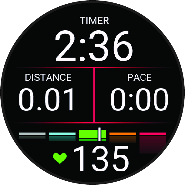

The first fitness activity you record on your watch can be a run, ride, or any outdoor activity. You may need to charge the watch before starting the activity (Charging the Watch).
The watch records activity data only while the activity timer is running.
  1. Press , and select an activity.
  2. Go outside, and wait while the watch locates satellites.
  3. Press .
  4. Go for a run.

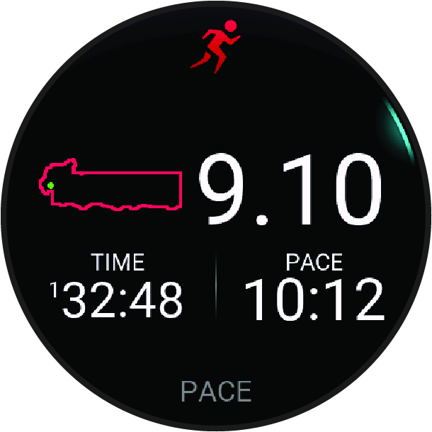

Starting a PacePro Plan
Before you can start a PacePro plan, you must download a plan from your Garmin Connect account, or create a PacePro plan on your watch (Creating a PacePro Plan on Your Watch).
  1. From the watch face, press .
  2. Select an outdoor running activity.
  3. Scroll down to select Training > PacePro Plans.
  4. Select a plan.
TIP: You can scroll down to preview the splits and elevation plot before you accept the PacePro plan.
  1. Press .
  2. Select Use Plan to start the plan.
  3. If necessary, select to enable course navigation.
  4. Press to start the activity timer.
Target split pace
Current split pace
Completion progress for the split
Distance remaining in the split
Overall time ahead of or behind your target time
TIP: You can hold , and select Stop PacePro > to stop the PacePro plan. The activity timer continues running.
