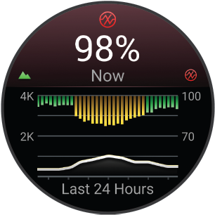

You can manually begin a pulse oximeter reading by viewing the pulse oximeter glance (Getting Pulse Oximeter Readings). You can also turn on all-day readings (Setting the Pulse Oximeter Mode). When you view the pulse oximeter glance while you are not moving, your watch analyzes your oxygen saturation and your elevation. The elevation profile helps indicate how your pulse oximeter readings are changing, relative to your to elevation.
On the watch, your pulse oximeter reading appears as an oxygen saturation percentage and color on the graph. On your Garmin Connect account, you can view additional details about your pulse oximeter readings, including trends over multiple days.

The elevation scale. |
A graph of your average oxygen saturation readings for the last 24 hours. |
Your most recent oxygen saturation reading. |
The oxygen saturation percentage scale. |
A graph of your elevation readings for the last 24 hours. |
