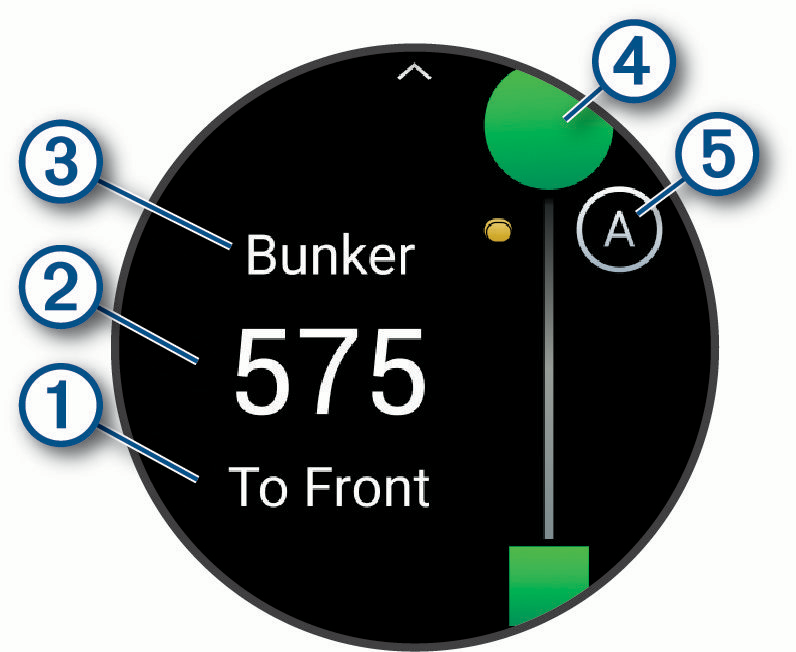

Viewing Hazards
You can view distances to hazards along the fairway for par 4 and 5 holes. Hazards that affect shot selection are displayed individually or in groups to help you determine the distance to layup or carry.
  1. Press .
  2. Select Hazards.
  • The direction and distance to the front or back of the nearest hazard appear on the screen.
  • The hazard type is listed at the top of the screen.
  • The green is represented as a half circle at the top of the screen. The line below the green represents the center of the fairway.
  • Hazards are indicated by a letter signifying the order of the hazards on the hole, and are shown below the green in approximate locations relative to the fairway.
