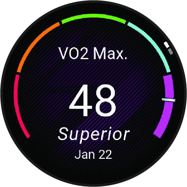

About VO2 Max. Estimates
VO2 max. is the maximum volume of oxygen (in milliliters) you can consume per minute per kilogram of body weight at your maximum performance. In simple terms, VO2 max. is an indication of athletic performance and should increase as your level of fitness improves. The Forerunner device requires wrist-based heart rate or a compatible chest heart rate monitor to display your VO2 max. estimate. The device has separate VO2 max. estimates for running and cycling. You must run either outside with GPS or ride with a compatible power meter at a moderate level of intensity for several minutes to get an accurate VO2 max. estimate.
On the device, your VO2 max. estimate appears as a number, description, and position on the color gauge. On your Garmin Connect account, you can view additional details about your VO2 max. estimate, such as where it ranks for your age and sex.
Purple
Superior
Blue
Excellent
Green
Good
Orange
Fair
Red
Poor
VO2 max. data is provided by Firstbeat Analytics. VO2 max. analysis is provided with permission from The Cooper Institute®. For more information, see the appendix (), and go to www.CooperInstitute.org.
Getting Your VO2 Max. Estimate for Running
This feature requires wrist-based heart rate or a compatible chest heart rate monitor. If you are using a chest heart rate monitor, you must put it on and pair it with your watch ().
For the most accurate estimate, complete the user profile setup (), and set your maximum heart rate (). The estimate may seem inaccurate at first. The watch requires a few runs to learn about your running performance. You can disable VO2 max. recording for ultra run and trail run activities if you do not want those run types to affect your VO2 max. estimate ().
  1. Start a running activity.
  2. Run for at least 10 minutes outdoors.
  3. After your run, select Save.
  4. Press UP or DOWN to scroll through the performance measurements.

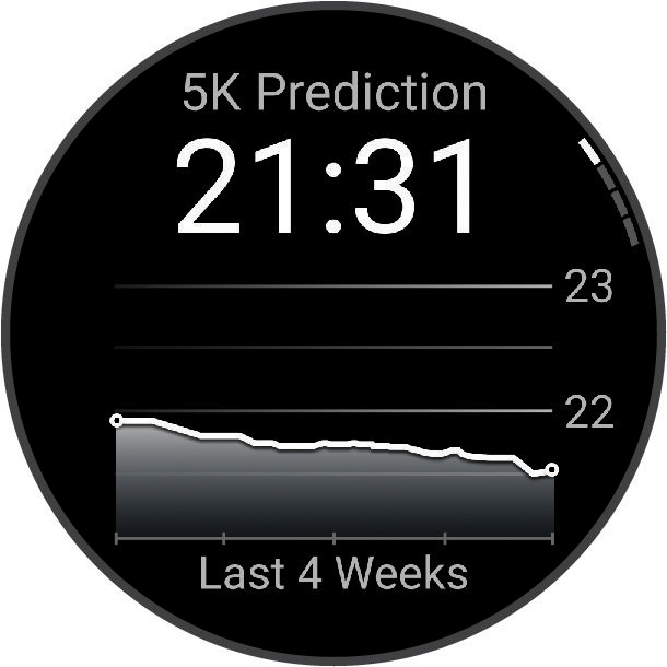

Viewing Your Predicted Race Times
Your watch uses the VO2 max. estimate () and your training history to provide a target race time. The watch analyzes several weeks of your training data to refine the race time estimates.
TIP: If you have more than one Garmin device, you can specify your primary training device in the Garmin Connect app, which allows your watch to sync activities, history, and data from other devices ().
  1. From the watch face, press UP or DOWN to view the performance glance.
  2. Press START to view glance details.
  3. Press UP or DOWN to view a predicted race time.
  1. Press START to view predictions for other distances.
NOTE: The predictions may seem inaccurate at first. The watch requires a few runs to learn about your running performance.

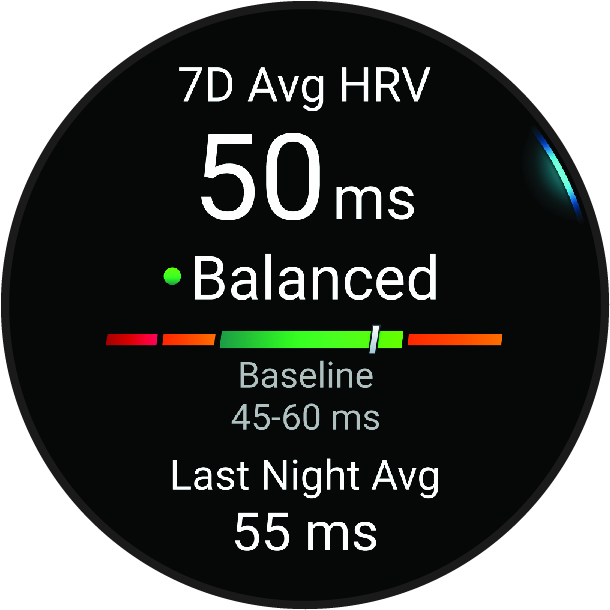

Heart Rate Variability Status
Your watch analyzes your wrist heart rate readings while you are sleeping to determine your heart rate variability (HRV). Training, physical activity, sleep, nutrition, and healthy habits all impact your heart rate variability. HRV values can vary widely based on gender, age, and fitness level. A balanced HRV status may indicate positive signs of health such as good training and recovery balance, greater cardiovascular fitness, and resilience to stress. An unbalanced or poor status may be a sign of fatigue, greater recovery needs, or increased stress. For best results, you should wear the watch while sleeping. The watch requires three weeks of consistent sleep data to display your heart rate variability status.
Color Zone
Status
Description
Green
Balanced
Your seven-day average HRV is within your baseline range.
Orange
Unbalanced
Your seven-day average HRV is above or below your baseline range.
Red
Low
Your seven-day average HRV is well below your baseline range.
No color
Poor
No status
Your HRV values are averaging well below the normal range for your age.
No status means that there is insufficient data to generate a seven-day average.

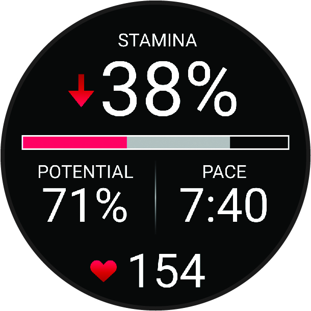

Viewing Your Real-Time Stamina
Your watch can provide real-time stamina estimates based on your heart rate data and VO2 max. estimate ().
  1. Hold .
  2. Select Activities & Apps.
  3. Select a run or bike activity.
  4. Select the activity settings.
  5. Select Data Screens > Add New > Stamina.
  6. Press UP or DOWN to change the location of the data screen (optional).
  7. Press START to edit the primary stamina data field (optional).
  8. Start your activity ().
  9. Press UP or DOWN to scroll to the data screen.
Primary stamina data field. Shows your current stamina percentage, distance remaining, or time remaining.
Potential stamina.
Current stamina.
Red: Stamina is depleting.
Orange: Stamina is steady.
Green: Stamina is recharging.
