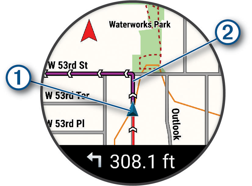

    • If you are not using direct routing, select Route to navigate back to the starting point of your activity using turn-by-turn directions.
Your current location and the track to follow appear on the map.
