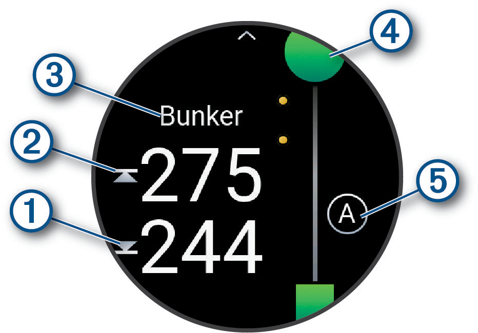

  • The distances to the front and back of the nearest hazard appear on the screen.
  • The hazard type is listed at the top of the screen.
  • The green is represented as a half circle at the top of the screen. The line below the green represents the center of the fairway.
  • Hazards are indicated by a letter signifying the order of the hazards on the hole, and are shown below the green in approximate locations relative to the fairway.
