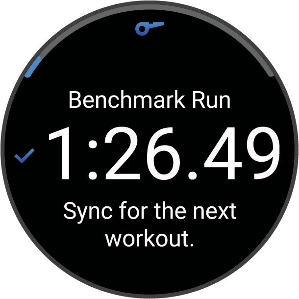

Adaptive Training Plans
Your Garmin Connect account has an adaptive training plan and Garmin coach to fit your training goals. For example, you can answer a few questions and find a plan to help you complete a 5 km race. The plan adjusts to your current level of fitness, coaching and schedule preferences, and race date. When you start a plan, the Garmin coach glance is added to the glance loop on your Forerunner watch.
Starting Today’s Workout
After you send a Garmin Coach training plan to your watch, the Garmin Coach glance appears in your glance loop ().
  1. From the watch face, press UP or DOWN to view the Garmin Coach glance.
    If a workout for this activity is scheduled for today, the watch shows the workout name and prompts you to start it.
  2. Press START.
  3. Press DOWN to view the workout steps (optional).
  4. Press START, and select Do Workout.
  5. Follow the on-screen instructions.
