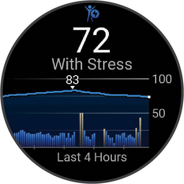

Viewing the Body Battery Glance
The Body Battery glance displays your current Body Battery level and a graph of your Body Battery level for the last several hours.

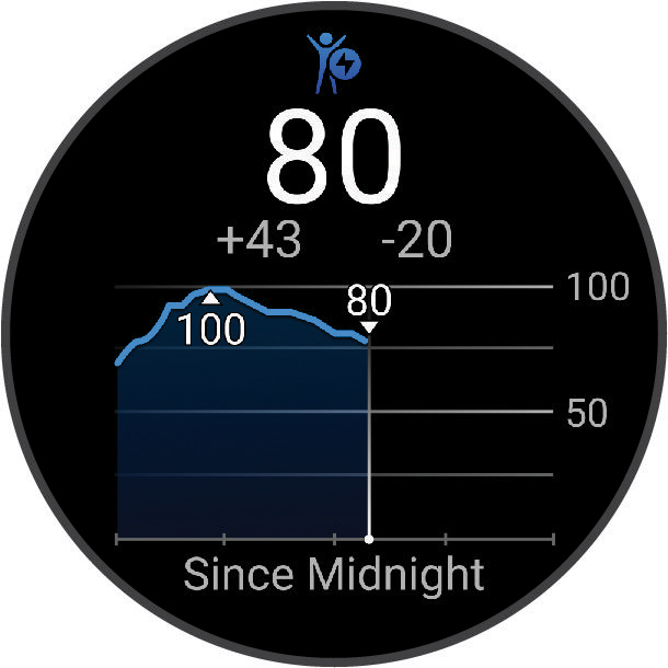

  1. Press UP or DOWN to view the Body Battery glance.
    NOTE: You may need to add the glance to your glance loop ().
  2. Press START to view a graph of your body battery level since midnight.
  3. Press DOWN to view a combined graph of your Body Battery and stress levels.
    Blue bars indicate periods of rest. Orange bars indicate periods of stress. Gray bars indicate times when you were too active to determine your stress level.
