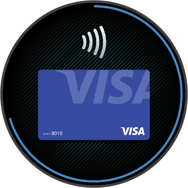

    Your most recently used payment card appears.
  4. If you have added multiple cards to your Garmin Pay wallet, swipe to change to another card (optional).
  5. If you have added multiple cards to your Garmin Pay wallet, select DOWN to change to another card (optional).
  6. Within 60 seconds, hold your watch near the payment reader, with the watch facing the reader.
    The watch vibrates and displays a check mark when it is finished communicating with the reader.
  7. If necessary, follow the instructions on the card reader to complete the transaction.
