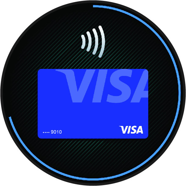

Your most recently used payment card appears.
- If you have added multiple cards to your Garmin Pay wallet, swipe to change to another card (optional).
- If you have added multiple cards to your Garmin Pay wallet, select DOWN to change to another card (optional).
- Within 60 seconds, hold your watch near the payment reader, with the watch facing the reader.
The watch vibrates and displays a check mark when it is finished communicating with the reader.
- If necessary, follow the instructions on the card reader to complete the transaction.
