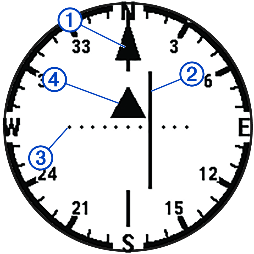

Course line pointer. Indicates the direction of the desired course line from your starting point to your next waypoint. |
Course deviation indicator (CDI). Indicates the location of the desired course line in relation to your location. If the CDI is aligned with the course line pointer, you are on course. |
Course deviation distance. The dots indicate your distance off course. The distance represented by each dot is indicated by the scale in the upper-right corner. |
To-and-from indicator. Indicates whether you are past the next waypoint. |
