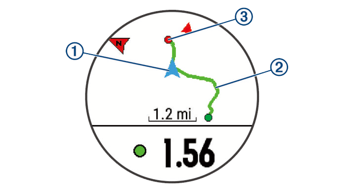

Your current location , the track to follow , and your destination appear on the map.
