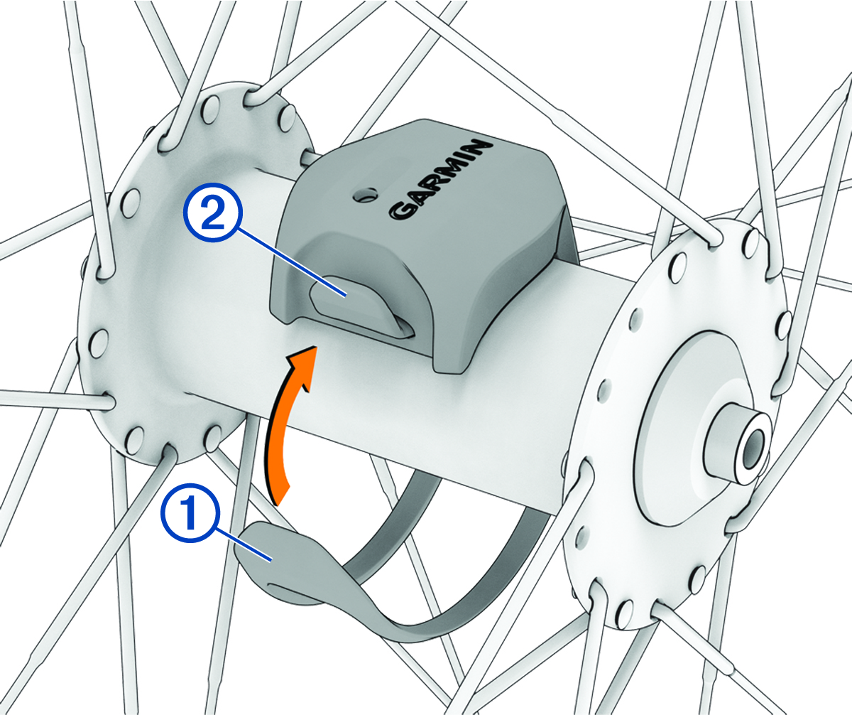

- Place and hold the speed sensor on top of the wheel hub.
- Pull the strap
around the wheel hub, and attach it to the hook
on the sensor.
The sensor may be tilted when installed on an asymmetrical hub. This does not affect operation.
- Rotate the wheel to check for clearance.
The sensor should not contact other parts of your bike.
NOTE: The LED flashes green for five seconds to indicate activity after two revolutions.
